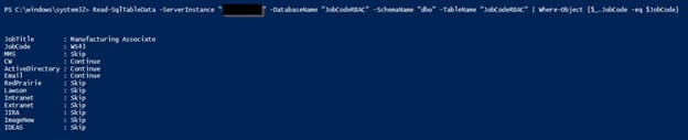

Here’s a sample of a query for the Job Code WS43:
Those values would be used to determine if a particular system access is to be granted or not. Basically, if the value returned is “Skip” then that Manual Activity status would be set to Skipped. If not, then no status change takes place.

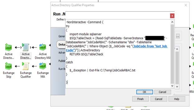

My .net script activity is basically just taking the data and passing it through to the qualifier.
If you look at the previous picture, you’ll see I pipe out the catch to a text file. All I keep getting in the text file as my exception is “Read-SQLTableData is not known as a valid command.” I’ve installed the SqlServer module on the Orchestrator server, and also on the SQL server housing the SQL table I am referencing.
So, I guess my question is (after all this rambling explanation) where is this .net script being run from? I would think as an Invoke-Command, it would be run from the SQL server. Outside of that, I would think it would be run from the Orchestrator server. Both of which have the module installed.
