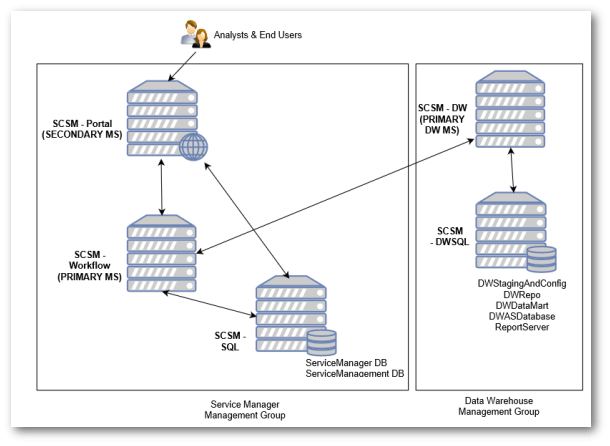

Contoso has successfully installed Service Manager using a typical configuration for a small to medium sized enterprise in a single domain environment. Contoso intends to use Service Manager as the service management tool for both the Technology and Human Resource departments. Active directory connectors have been configured and have populated the CMDB with all AD users and groups. An SCCM connector has been configured to populate all computers configuration items. Support group lists for the incident and service request class have been populated with values ‘Service Desk’, ‘HR’ and ‘infrastructure’.
SCSM-Workflow: Primary Service Manager Management Server \\ Workflow Server
SMSM-Portal: Secondary Service Manager Management Server, which will host the Cireson Portal
SCSM-SQL: SQL Server that will host the Service Manager DB and the Portal’s Service Manager DB on the same SQL instance
SCSM-DW: Primary Datawarehouse Management Server
SCSM-DWSQL: SQL Server hosting Service Manager Datawarehouse, SSRS reporting and Analysis services.

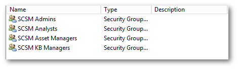

1.      Create Active Directory Groups
In Active Directory Contoso create the below new groups and nest the departmental groups that already exist in Contoso’s AD environment as per requirements
a.      SCSM-Analysts
Members: Contoso-Servicedesk, Contoso-HR, Contoso-infrastructure
b.      SCSM-KBManagers
Members: Contoso-Servicedesk, Contoso-infrastructure
c.       SCSM-AssetManagers
d.      SCSM-Admins
Members: Contoso-infrastructure

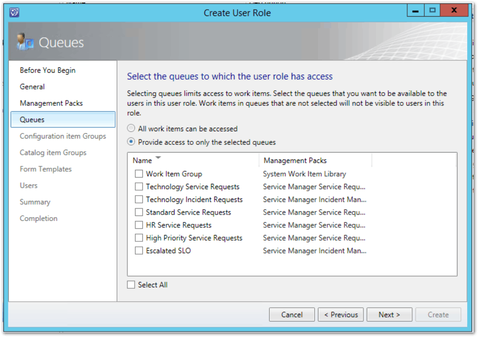

3.      Configure SCSM Queues
In the SCSM console create queues and groups so the roles can be scoped as per the requirements above. More information on queues and groups can be found here

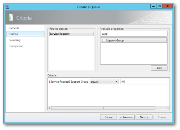

a.       Create a new queue called HR Service Requests , targeting the service request class, the Criteria of this queue = Support group equals HR
b.      Create a new queue called Technology Service Requests , targeting the service request class, the Criteria of this queue = Support group does not equal HR
c.       Create a new queue called Technology Incident Requests , targeting the service request class, the Criteria of this queue = Support group does not equal HR

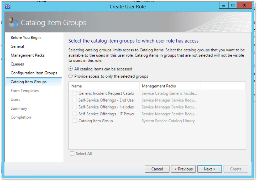

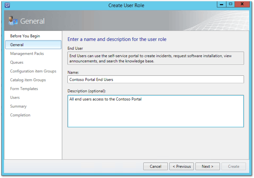

a.       Create user role based on the end user role named Contoso Portal End Users
Tick select all on the management pack prompt, select Provide access to only the select queues and ensure all queues are unticked (We do this as we want users to only get implied permissions to work items where they are the affected user, we don’t want them to have the ability to type the URL of a work item and stumble on a sensitive ticket for someone else)

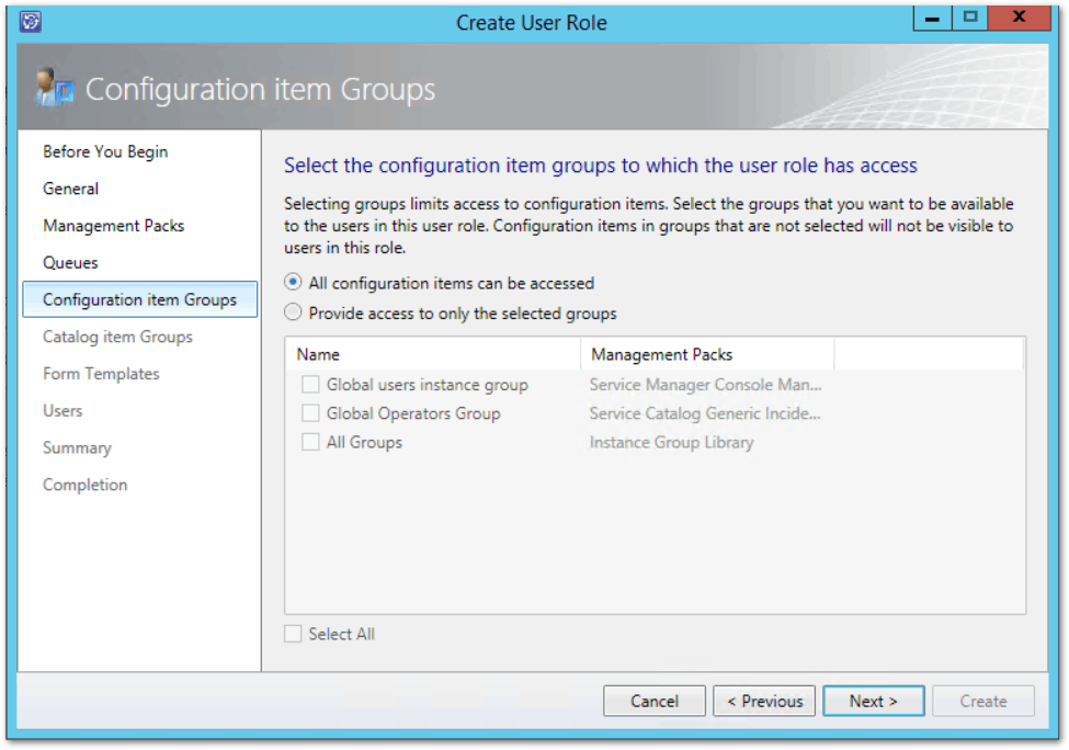

Select All configuration items can be accessed
 Select All catalog items can be accessed (In this scenario we want all users to see all request offerings – if you want to only show certain request offerings this is where you would target your catalog item group of request offerings the user role can access)

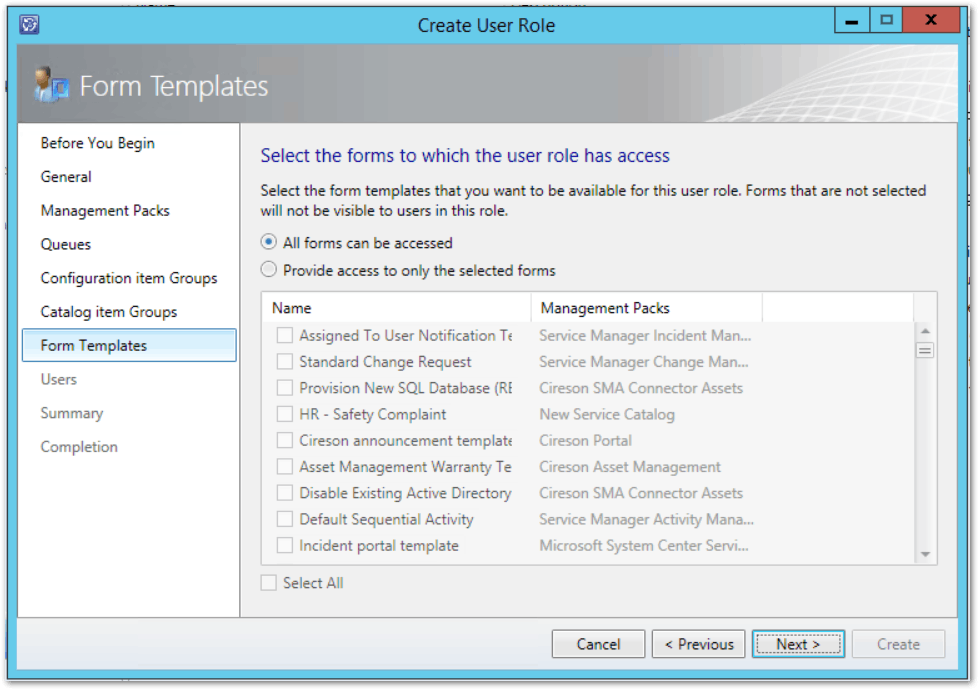

Select All forms can be accessed

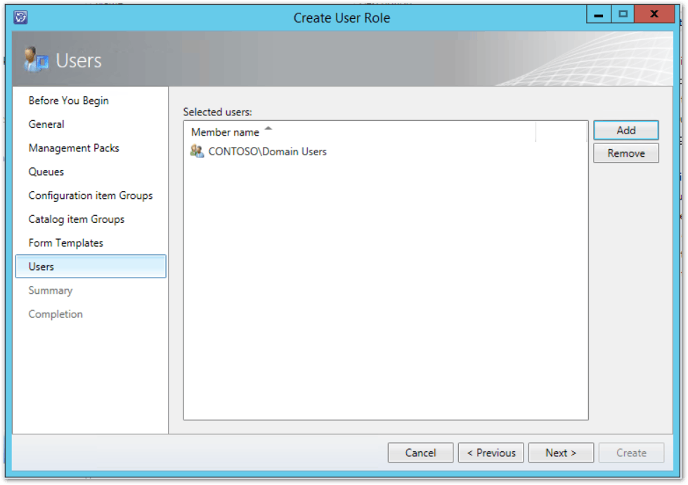

Add group Domain Users (you cannot user the authenticated users group with the Cireson portal) to the role and select Next, then Create.
b.      Create user role based on the advanced operator role named Contoso Service Desk Analysts, tick select all on the management pack prompt, select Provide access to only the select queues and select Technology Service Requests and Technology Incident Requests, select All configuration items can be accessed, select All catalog items can be accessed, Select All Tasks can be accessed, Select All views can be accessed (this only applies to console views, the cireson portal has its own navigation node scoping), select All forms can be accessed, Add group Contoso-Servicedesk to the role and select Create.
c.       Create user role based on the Service Request Analyst role named Contoso HR Analysts, tick select all on the management pack prompt, select Provide access to only the select queues and select HR Service Requests,select All configuration items can be accessed, select All catalog items can be accessed, Select All Tasks can be accessed, Select All views can be accessed (this only applies to console views, the cireson portal has its own navigation node scoping), select All forms can be accessed, Add group Contoso-HR to the role and select Create
