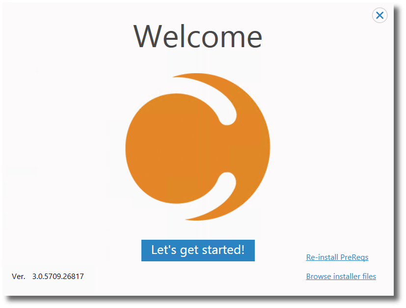

Navigate to https://support.cireson.com/software on SCSM-Portal find Cireson Portal v5.0 and click Install, for installing on a server without internet access see KB20.
  • Select Let’s get started!

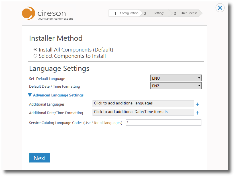

  • Select Install All Components. Select the default Language and any Date / Time formats (I’m based out of New Zealand so I will want the proper date format
     ) click next.

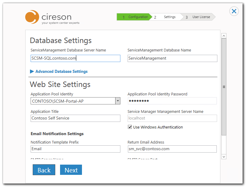

  • Enter the Database, Website and Email settings as per the requirements. Note password validation is done on this step so make sure triangle has gone before continuing. Click next.
Summary of these settings:
Application Title - this is the value that will be displayed and in the upper left of the header. Contoso will name this Contoso Self Service
Service Manager Management Server Name – Contoso will use Windows Authentication for SSO, so the management server name must be localhost.  If you are using Forms Authentication and the management server is also installed on the computer where you are installing the Cireson Portal web site then enter 'localhost'.
Application Pool IdentityContoso\\SCSM PortalAP as created from part 1, account is already a local administrator and SCSM administrator.
Application Pool Identity Password - Password for the Application Pool Identity. In some cases the installer may not be able to verify the credentials provided and will show a warning. If you are certain that you have entered the correct credentials, you may proceed.
Notification Template Prefix - this setting is used to filter out the list of notification templates which should be shown on the Send Email dialog in the Cireson Portal. Only those notification templates which have a display name that starts with the specified prefix value will be shown. Templates for the portal will be created in the future by Contoso matching this default naming convention prefix.
Return Email Address - this is the email address that will be set as the return email address of any email sent via the Cireson Portal.
SMTP Server Name - the name of the SMTP server to connect to when sending email.
SMTP Server Port - the port number to be used.

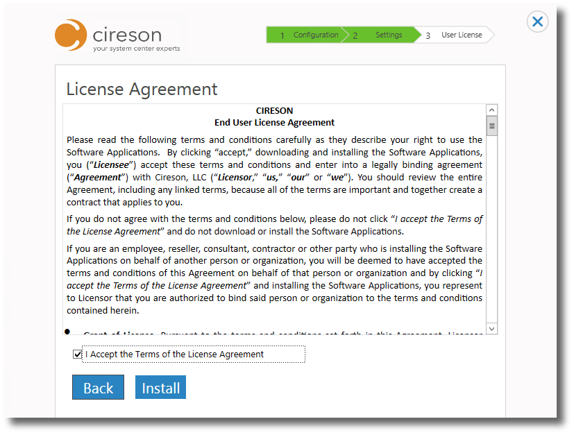

  • Read through the full license agreement like you always do on an installer and click install and get ready to love your life!

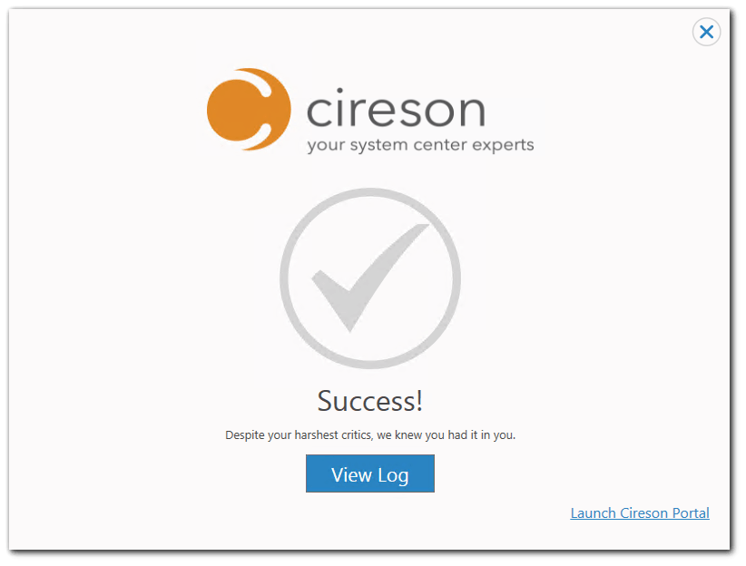

  • All going well you should see a screen free from errors and be ready to move onto upgrade for the next server. If you do see an error correct the errors (usually permission related) re-run the above. If install still fails Cireson’s amazing global support team are always available to help.

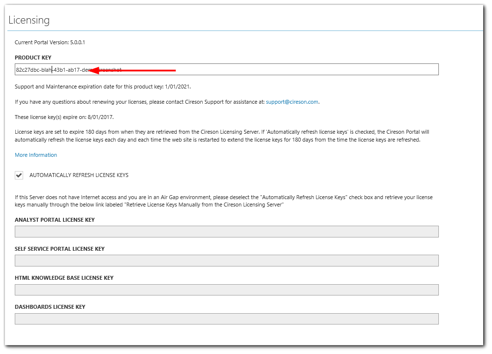

1) License the portal with Product Key
  • From the installer click Launch Cireson Portal or navigate to localhost on the portal server’s web browser.
  • Enter the Product Key provided by Cireson and click Save
Please review KB1180 for more information on licensing the cireson portal and for troubleshooting tips, after install the cachebuilder must complete a full cycle to generate your unique environment hash to be able to check-in your product key with the licensing server.

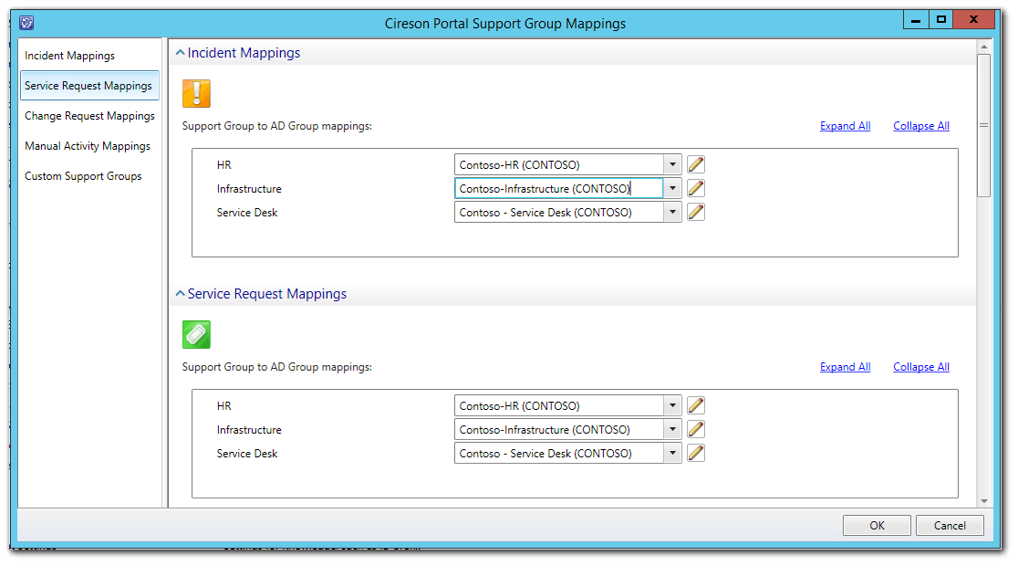

2) Configure Portal Group Mappings
The Team Work view allows for analysts to see all the work items within their assigned support group, however the support group value must be linked with an AD group so the portal knows which team has which analysts as members.
  • Open the SCSM console and navigate to Administration -> Settings -> Cireson – Portal Group Mapping Settings
  • Add AD group for each list value: HR, Infrastructure, Service Desk
For more information on view criteria see KB1103

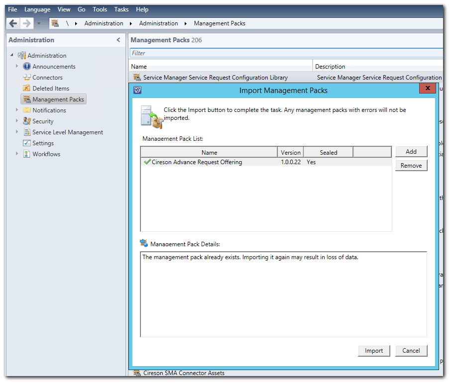

3) Import the Advanced Request Offering Management Pack
Installing the Cireson Portal will not automatically install the Advance Request Offering management pack. This is intended to be an additional step as installing the Advance Request Offering management pack will update ALL of your Incident and Service Request Last Modified dates for each work item in the ServiceManager CMDB. On large data sets this can and will result in performance issues while Service Manager processes the changes across the affected work items. This is a core Service Manager function (limitation) and therefore nothing we can do to alleviate or remedy these effects.  Please test the impacts of this management pack prior to deploying into your production environment to ensure your production system can process the changes without impacting the usability of your production system until they have completed.
But as this is a new install of SCSM Contoso can proceed with the import
  • After installing the portal, you can locate the Advance Request Offering mpb in the ManagementPacks directory within the Cireson install directory and import from the console. eg C:\\Inetpub\\CiresonPortal\\ManagementPacks (if you kept the default settings).
For more information, see KB1270
